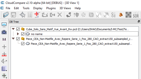

As I have compiled the CC, in debug version, I can load a .pcd file, in the file tree window, the folder name can be shown correctly, but the file is named as 'no name', as show in the photo, where the one above is a .pcd file and the one below is from a .txt file.<br/>
How can we fix this issue?<br/>

Here is the image.
- Capture.PNG (30.05 KiB) Viewed 144888 times

For the "no name" I guess the PCD filter is not doing its job properly.
The cloud should be named somewhere in the PcdFilter class (probably at the end of the loadFile method) with the 'setName' method.
By default I believe the cloud should be named "unnamed - Cloud" so that CloudCompare can automatically replace the "unnamed" part by the filename. Otherwise you can set anything you want.
