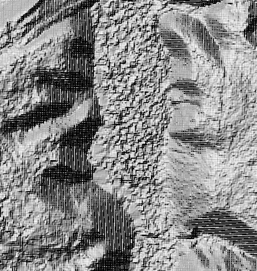

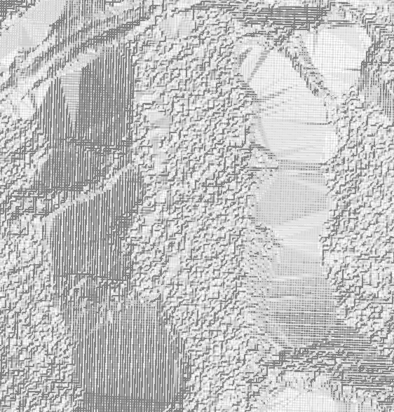

I enter a problem when creating a DEM. I can't get slopes identical to the real one.
I have tried several treatments using CSF filter, but I don't get the expected result.
Does anyone have an idea? Thank you in advance.
Thibault
create digital elevation models
- Cloudcompare_DEM.PNG (262.06 KiB) Viewed 124400 times
- réalité_DEM.PNG (266.23 KiB) Viewed 124400 times
Re: create digital elevation models
Hard to visualize, but it seems that too much points are removed from the original cloud by the CSF plugin? What does the original cloud look like?
