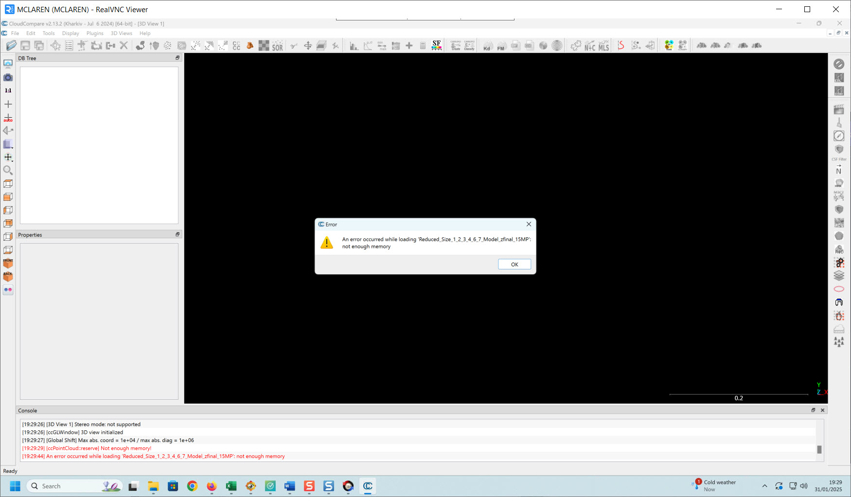

Good evening,
I have run into an issue opening a large .LAS pointcloud.

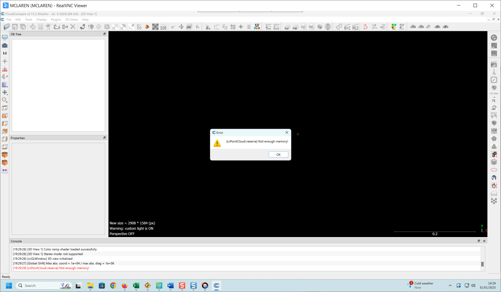

After "Oking" the first two boxes i get the first warning:
And then the second one:
I am unsure as to the reason. This is the latest stable release (2.13.2 Kharkiv (7/08/2024)), and the machein has 128Gb of RAM.
All the best,
Chris
Re: Issue opening .LAS
Well, I guess either the cloud/file is massive, or it's corrupted and CloudCompare tries to create a cloud with a ridiculously big number of points...
You could try to use the latest 2.14.alpha version in case it fixes something, but I doubt it will change something sadly.

Thank you for getting back to me.
File size, the cloud is 29GB, and just over 1.1 billion points.
The machine I am using is a brand new build.
The same cloud does open on our other machines, which are 2 years old, 64GB ram, and there running version 12.2.
Would it help if you got a copy of the cloud to test your end?
All the best,
Chris
chris_harvey83
Joined: Thu Dec 08, 2022 10:02 am
Post by chris_harvey83 »
Just wanted to update you, using the latest alpha build the point cloud loads with no issues.
Thanks for your advise,
Chris
That's surprising in a way, but also a good news :D
