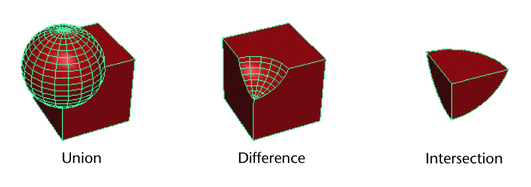

Hello !
Would it be possible to add some boolean operations (Union, Difference, Intersection) with meshes.
Thanks :)

That's funny because I recently tested at work a very nice library for performing boolean operations on meshes (cork: https://github.com/gilbo/cork).
My only concern is about the 'Cloud' in CloudCompare... CloudCompare is not really a meshing tool. What about MeshLab? Can it do this kind of stuff?
If you convince me that MeshLab can't (properly) do it, I'll integrate Cork in CloudCompare ;)

Ok, CC has now a CSG-capable plugin based on the Cork library:
http://www.cloudcompare.org/doc/wiki/in ... PluginCork
The latest release (2.6.0) now incorporates this plugin.
