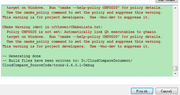

These are my steps when I build CC with Qt Creator :
1.Open project and select CC CMakeLists.txt
2.Qt Creator will ask you to select build directory and input arguments(e.g. -DCMAKE_BUILD_TYPE=Debug ...)
run cmake.PNG (6.09 KiB) Viewed 9900 times
generating done.PNG (19.26 KiB) Viewed 9900 times

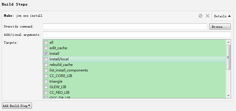

3.Configure the build steps
build steps.PNG (14.02 KiB) Viewed 9900 times
I build CC again, but the problem was not fixed.
