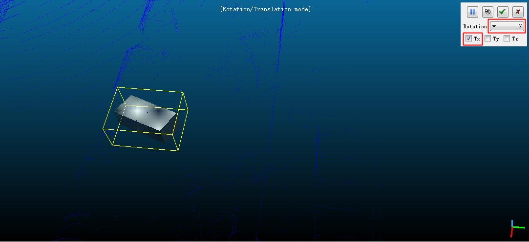

I use the 'Translate/Rotate' method to translate or rotate the box primitive in a point cloud.
But I want to rotate the box relative to the box own coordinates. For example, I can rotate/translate the box in the direction of the x axis of the box when I select the x in the 'translate/rotate' dialog (like blow).
box coordinate.jpg (80.14 KiB) Viewed 11111 times
How to create a box primitive coordinate in the point cloud, so I can rotate or translate the box relative to its own coordinates rather than the point cloud coordinate?

This is not possible by default in CloudCompare (with the 'Manual Transformation' tool).
However you could look at the 'Cross Section' tool that works the same way as what you are looking for. You could use an object similar to the 'ccClipBox' object (see https://github.com/cloudcompare/trunk/b ... cClipBox.h).
