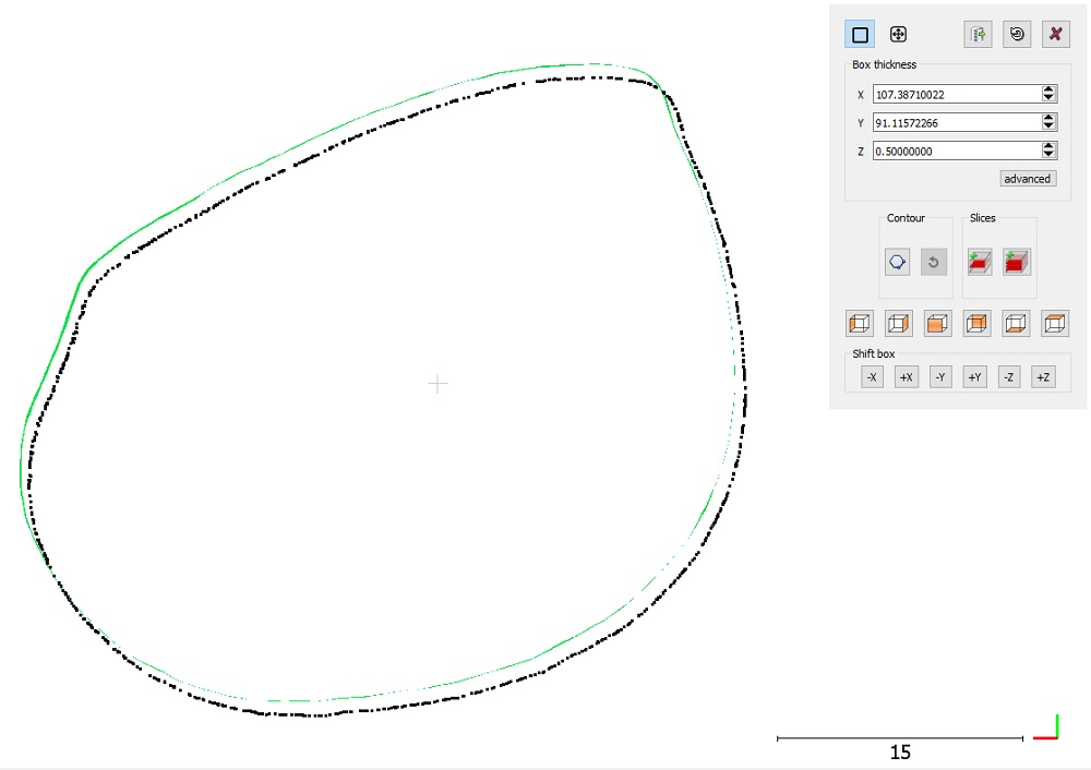

Well, in a way you can already extract the points along a line or a polyline (with the 'section extraction' tool). You can do that on both clouds (with the same line). Then the remaining gap might be to properly display/visually compare the results (especially if the result cannot be projected on a plane).
In a more limited way, you can use the Cross Section tool (or 'Clipping box') with the two (or more) entities selected. Then clip the points you want to compare - typically with a thin slice - and eventually hide the box interactors so as to only see the points (you can even set the view parallel to the cut).

Reading the topic now I can use the "extract cloud section" tool, which is one of the most useful for me. Thanks for that a lot!!
But it would be more efficient, if I could make the selections on more clouds with one line, and not just defining the section line one one cloud and open again and again on the others. Is it possible somehow?

I think that now both the 'Cross Section' and 'Section extraction' tools work with multiple clouds, don't they? (you'll have to use a recent version of course ;).
The 'Cross Section' tool works with meshes as well, but not for polyline section extraction.

I mean it works well with the extract section tool.
If I set just one cloud, but another is also open but not set, the cross section will affect just the set one, and not all of that.
But if I try to set more than one cloud for the "cross"section" tool, the button disappears.

I'm confused. Which are you using here? The Cross Section tool? (then you have to use the colored torii if you want to rotate the clouds, and you have to move the mouse horizontally or vertically depending on the axis).
But in general I wouldn't advise using any manual registration. You can extract some slices if that's what you want to use as reference, and then apply a proper registration tool (Point-pair alignment or ICP). And eventually use the resulting transformation matrix (output in the Console) on the original cloud for instance.

I am selecting two clouds (overlapping clouds to see the changes between them) before selecting Extract Sections Tool, but Section contour ( with Vertices on) show only one line so I can't figure it out how it works. ( clouds cannot be identical due to processing) .
