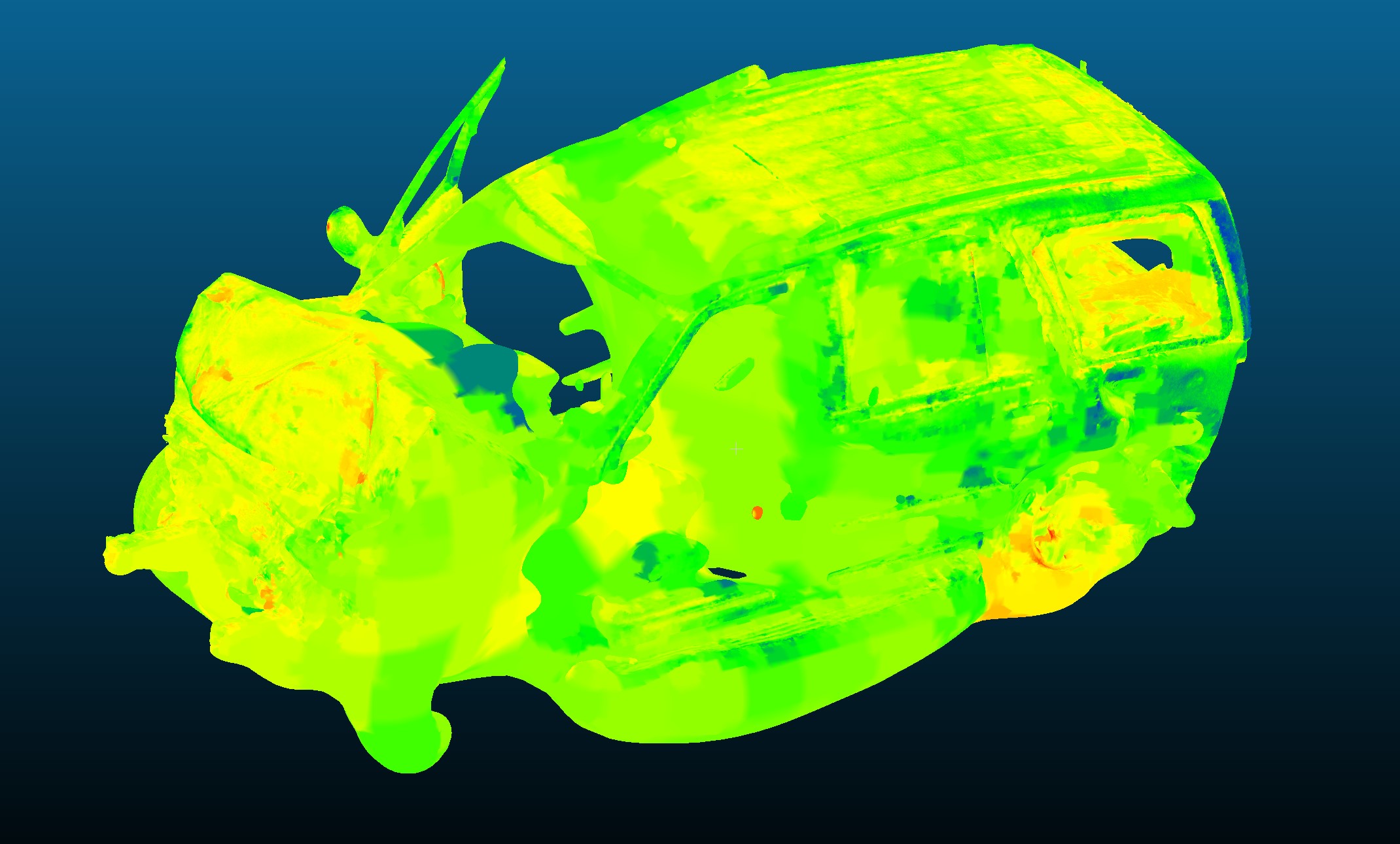

I've been dabbling with the poissonrecon.exe to mesh PLY files exported from CC.
However it does not seem that the --density parameter of poissonrecon.exe is outputting values that CC can use to edit the scalar field. See attached image.
Should this work?
Does the library CC uses for poisson reconstruction work differently than the .exe?
Here is the cmd line parameters I'm using:
PoissonRecon.exe --in test.ply --out meshed_test.ply --depth 11 --normals --pointWeight 1 --density --samplesPerNode 5 --bType 3
Screenshot 2020-10-28 150651.jpg (298.25 KiB) Viewed 124846 times

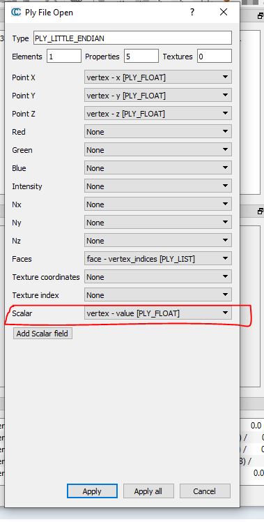

You're using the `--density` flag correctly. When you do so it adds a vertex attribute named `value`. Just make sure you select that attribute as a scalar field, see below, when you import the resulting ply in to CloudCompare.

jedfrechette wrote: Fri Oct 30, 2020 11:41 pm You're using the `--density` flag correctly. When you do so it adds a vertex attribute named `value`. Just make sure you select that attribute as a scalar field, see below, when you import the resulting ply in to CloudCompare.
Is it possible to Load the Mesh(PLY File) via CLI specifying Scalar field with vertex-Value??
As mentioned above i am able to load the Mesh File by specifying the Scalar field as shown using UI but i am unable to implement it via CLI, kindly help.
Re: PoissonRecon.exe to output density SF CC can use?
Right now, with CLI, the only way for CC to recognize a PLY filed as being a scalar field is that the field name starts with 'scalar'. You can manually add a 'scalar_' prefix to any PLY file with a text editor such as Notepad++ or with a small script (PLY files header is always in text/ASCII mode).
abhishek
Joined: Tue May 16, 2023 12:18 pm
Post by abhishek »
Thank you so much for the response, let me try it out and will update here the results.
