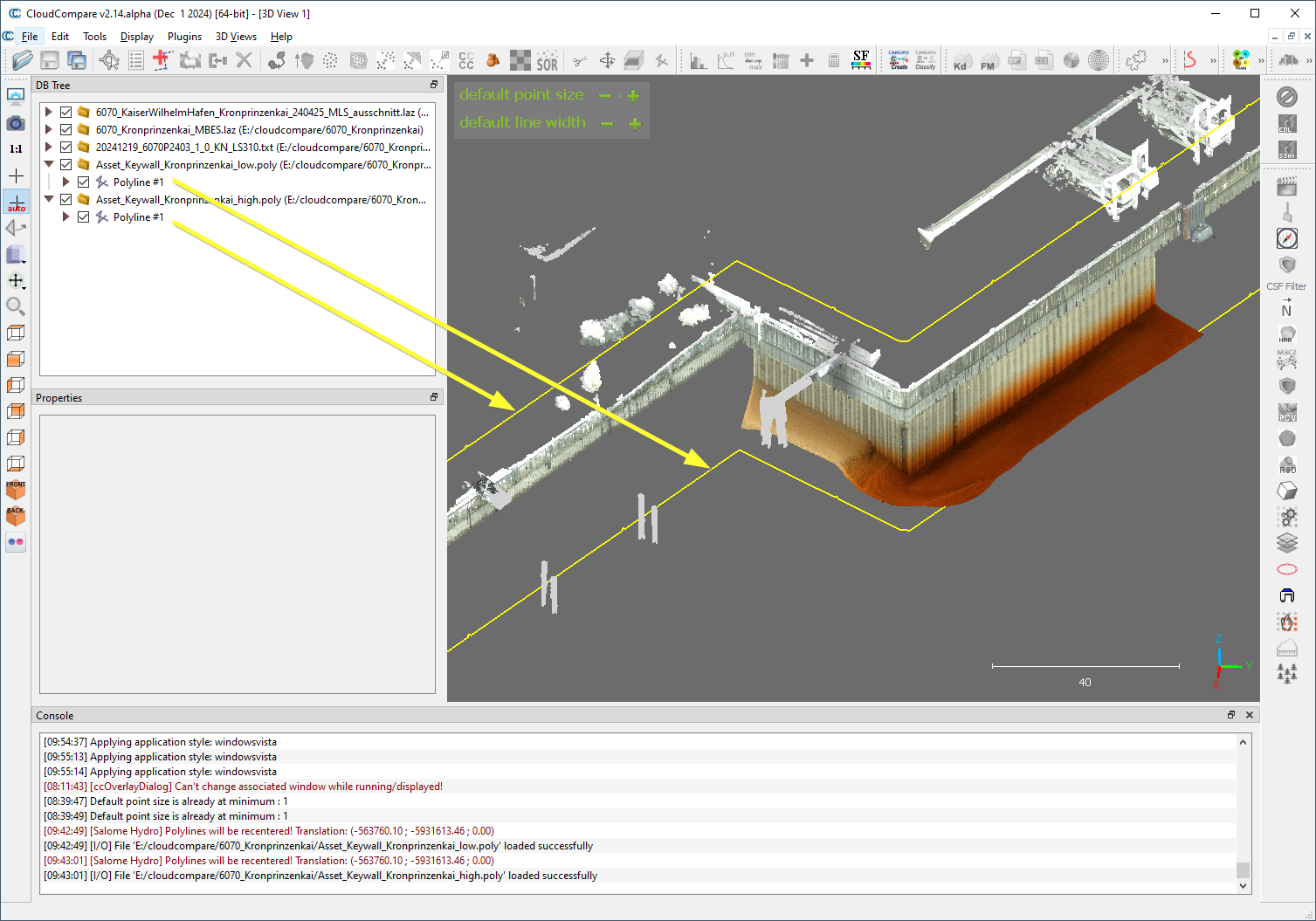

we did a laserscan (and sonar multibeam) of a keywall in a harbour area. I want to colorize the wall against a vertical surface. This is to see if there are any bendings in the keywall. The vertical surface cannot be a simple plane but must be following a given polyline. So i generated two polylines with the same horizontal coordinates but different z values.
Now i use the tool [Edit]->[Mesh]->[Surface between 2 polylines] to generate the surface. Within the following promt i decided to use the best fit plane. The surface is generated.

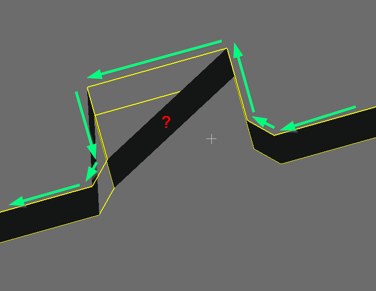

The result of the surface is fine on the wider areas biut there are several small notches in the polyline where the surface is not generated in the way I was expecting it.
The two polylines are attached.
So is there a way to change the behavior of the gerneration of the surface so that i will follow the line?
(Using 2.14 alpha Dec 1 2024)
Kind regards, Olli
Asset_Keywall_Kronprinzenkai.zip
(3.48 KiB) Downloaded 1651 times

Sadly this tool relies on 2.5D triangulation, so it's not able to properly manage these small corners (which are 'overlapping' the wall when projected in the global orientation chosen by the tool).
What you are looking for is more an 'extrusion' tool. That's very easy to code, but sadly that's not present in CloudCompare!

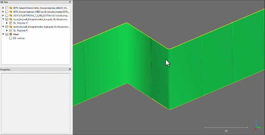

thank you for the hint with the OFF mesh file format. That works perfectly.
With your formula as a beginning I was able to to create it by myself. Instead of creating triangles I ended up created squares. With triangles the front and backsite of the faces were not consistent and flipped. (https://people.sc.fsu.edu/~jburkardt/data/off/off.html)
Just for further reference that was my result where i could compute the distance between pointcloud and the created mesh.
If anybody is interested in doing this programmatically with just a bunch of given coordinates (polyline) feel free to add a comment.
