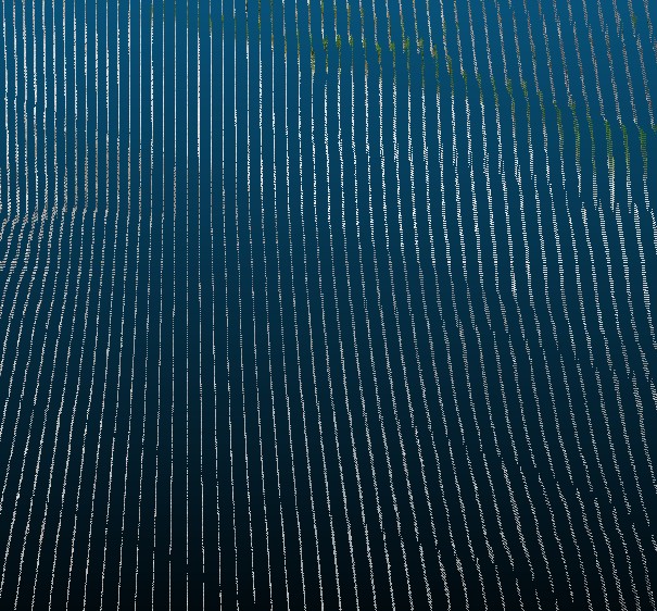

I have a .las point cloud file exported from WebODM. When I open it in CloudCompare (tested with both v2.14 and v2.12.4), the cloud appears cut into vertical slices — like regularly spaced bands or missing sections.
However, when I open the same .las file in Cyclone 3DR, it looks completely fine — all points are there.
The issue is not just visual: when I export the file again from CloudCompare (even after applying Edit > Subsample > Random), the exported file still contains the same slices — as if only partial data was present.
- Capture d’écran 2025-06-03 134705.jpg (158.02 KiB) Viewed 8175 times

Ah ah, If I got 1$ every time this question is asked...
This is due to large coordinates. See the warning when you load the LAS file about large coordinates, and why a 'Global shift' should be applied at loading time to reduce the amplitude of the coordinates. You should always apply a shift that's sufficient to reduce the very large coordinate to something < 10^3 or 10^4. Unless you'll lose accuracy.
Mind that this shift is only temporary. Everything is restored when exporting the cloud later.
