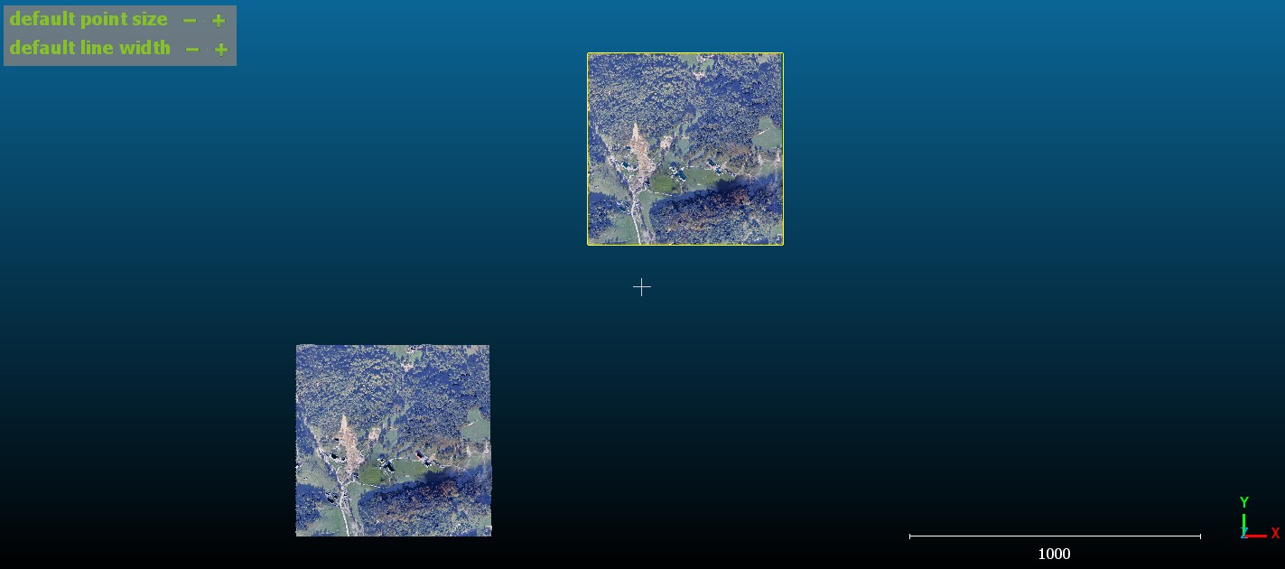

I have weird problems when trying using "Apply transformation" to my LAS cloud.
To make it simple (beause it is always the same problem):

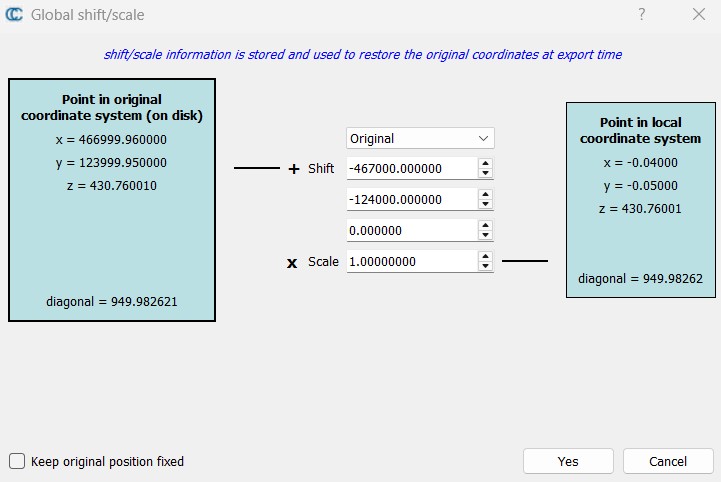

- I have two clouds with the same global shift (IMG01)
- Cloud 1 is reference cloud, coloud 2 is the one that needs to be aligned.
- I make a duplicate of the origial cloud 2.
- I register the cloud 2 to cloud 1 and copy the transformation matrix.
- I try to apply transformation to the duplicated cloud 2 using matrix.

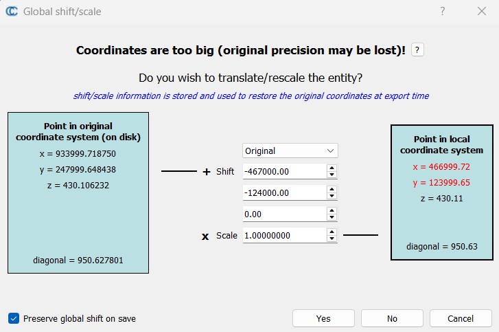

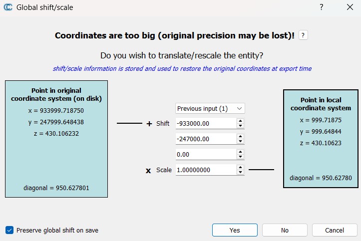

- I get weird data about the point in the original coordinate system and unlogical values in the right box (Previous input 1 option).
- I get weird data about the point in the original coordinate system and unlogical values in the right box (Original option).
- When I preform the transofrmation, clouds are not aligned.
What could be the reason and trick for solving this issue? Thanks!
