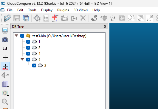

after merge some pc lost
if one pc is sub and it is the last in the list and the main pc is collapsed
Screenshot 2025-11-15 161652.png (36.07 KiB) Viewed 54615 times
Screenshot 2025-11-15 170247.png (32.7 KiB) Viewed 54610 times
Re: after merge some pc lost
Yes, it's a bit tricky, but if the point cloud is not in the selection (because its parent is collapsed), then the merge tool will only merge the selected clouds and ignore the child entities... It's a bit misleading. I'll add a warning so that the user is aware of the issue at least.
Post by DA523 »
but in stable CC, it deletes all and keep one merged pc ( child pc is deleted and lost )
in beta CC ,it keeps all but merge selected (no things lost)
