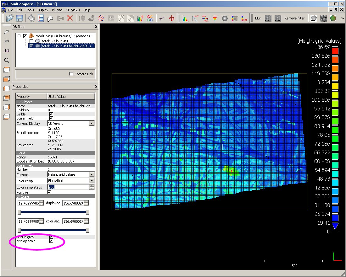

I forgot something:
Once you have a scalar field, check the 'display scale' checkbox at the bottom of the cloud 'Porperties', in the 'SF Scale' section (left side of the screen). See attached example.
Daniel
Daniel
- Scalar field scale bar example
- cc_sf_scale.jpg (268.89 KiB) Viewed 26027 times
