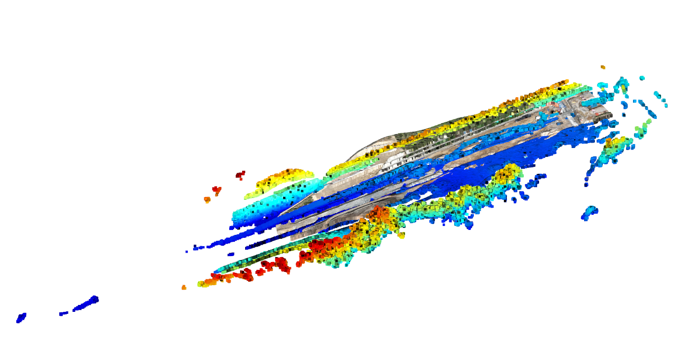

Hi, I expect there are many questions on this topic but I couldn't find it and I know I can figure it out by analyzing the code. But I don't know C++ so I'm sorry for asking.
I got good results (qualitatively) with fine registration with 50% final overlap using CloudCompare. I would like to use the same results for my project. Is there a special pipeline?
It seems to be very fast with autoscaling (I didn't select any scaling options).
The pictures show the results using Open3D and SGD-ICP and the results using CloudCompare.
Thanks.
