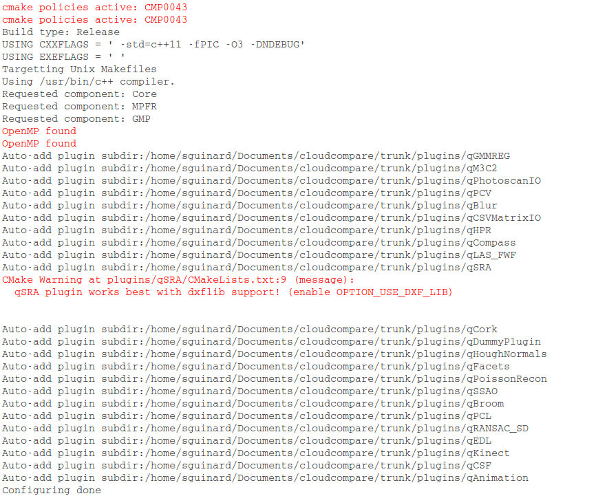

Can you provide us with your CMake configuration? (one or several screenshots would be good)
Re: loading plugins with CC 2.9 beta on ubuntu
Thanks for the quick answer
The options are in the cmake-1 & cmake-2 images and the configuration is in cmake-3
And the installation is in cmake-4
I'm afraid to not understand the issue here.
the runtime path point to '/usr/local/lib/cloudcompare/plugins' as proved by your last printscreen
yes, but CC was searching for the plugins in /usr/lib/cloudcompare/plugins , which is not the place they have been installed,
that's what i wanted to say at first
