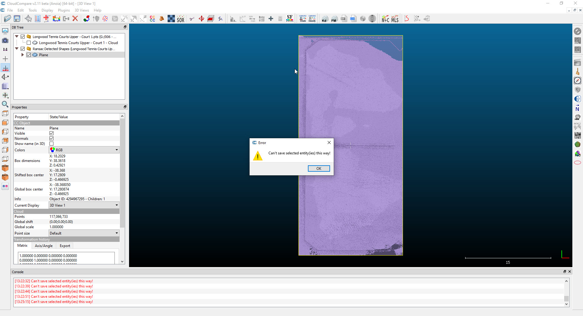

Yep. I have tried just selecting the PTS file, just the plane, and have tried selecting all the files and get the same message.

That's super strange. Do you have the same behavior with a smaller cloud?

Yep. I have tried a few different files and keep getting the same error.
Posts: 8195
Re: Saving Error
Looking at the code, the only way you can get this error message is that you have in your selection: no cloud, no mesh, no image, no polyline and no 'CloudCompare' entity (groups, labels, etc.).
Which is clearly not the case... I don't know what to say...

Here is a screen snap of it.
saving error.jpg (342.49 KiB) Viewed 19394 times

Can you send me any of these files? (admin [at] cloudcompare.org)

I just sent you the link. Let me know if you get it or not.
Posts: 8195
Re: Saving Error
Thanks for the file. And... I tested it and didn't experience any issue (with the 2.11 version). That's probably related to something else but I'm not sure what ?!

Hey, I had this exact issue with v 2.11 as well! I went back to using 2.10.2 for now. If I remember correctly, it was a CC instance I had open for a long time (probably days). Nothing I tried would let me save anything, so I just had to close it.
