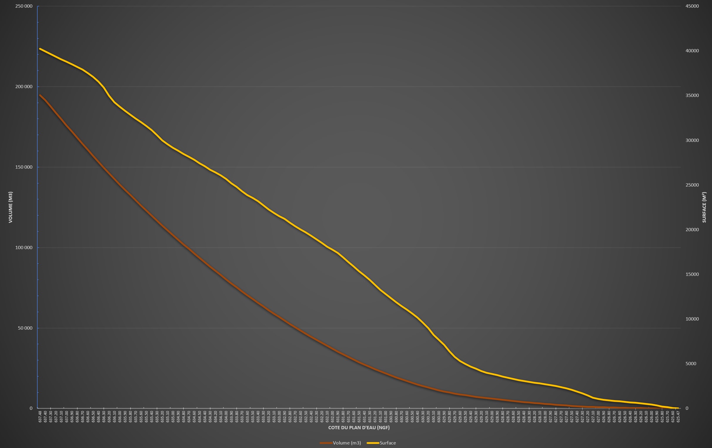

Is there a way to automate the generation of a chart with Height/surface/volume by choosing the z step and a point cloud ?
Like the volume tool but with an automatic step calculator.
Thank you.

Not sure to fully understand. Do you have an example of such a chart maybe?

Yes i have such an exemple. See attached.
Capture d’écran 2022-11-17 094614.jpg (205.08 KiB) Viewed 11190 times

Hum, that is definitely not possible right now. I'll add this idea to the TODO list, but it's always hard to find someone willing to implement these numerous ideas...
