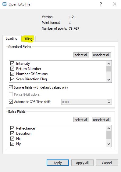

I am using 2.13. Should the function be visible when you import a LAS file? I have downloaded the plugin and I can see it in the "About Plugins" window but cant see an additional tile tab. Is anyone using it in 2.13?
Posts: 8195
Re: Lidar tiling on import in 2.13 vs 2.12
Yes, you should see it when loading any LAS/LAZ file (make sure to use the latest 2.13.alpha version, just in case you have one of the very first released alpha version):
