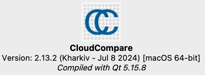

I guess it's related to the github issue?
I'm also concerned that the 2.13 version is getting quite old. We should ask Paul Rascle to create a new binary with the latest 2.14.alpha version...

I just built 2.14.alpha from source and the problem I still there. I can't save anything!!
Re: Can't save .las/.laz files on Mac
Isn't it different from the initial message? Because at that time the LAS saving dialog was visible...
Anyway, macOS is a different world. So maybe now that you have compiled the project there (good job by the way), you can debug things a little bit?
Sadly the build was a little broken, so I got rid off it. However, from the git issue a tip that worked for mac is to disable "Use native load / save dialog box" from display settigns.
Thanks, I've linked your message on the git issue discussion: https://github.com/CloudCompare/CloudCo ... ssues/2152
