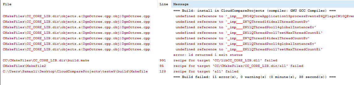

Hello, I was trying to build CC with Code::Blocks, after using CMake as indicated, and I got some problems, any ideas about this kind of errors ?

This looks like either a bad configuration of Qt path in CMake, or a wrong version of Qt used.

Thanks daniel for your reply, can you tell me what version of qt i should use ?

You can use any version anterior to 5.6. But you need a version compiled with mingw (64 bits).

Thanks daniel ill try with 5.5

Sorry I meant 'posterior' in this case :) (5.6, 5.7 or 5.8)
