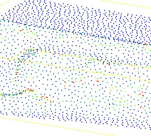

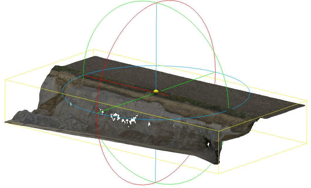

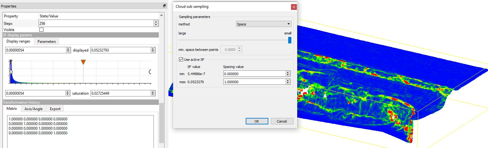

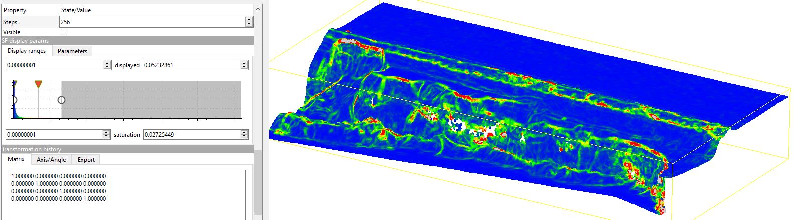

here are 5 screnshots with the following:
1) orig. Pointcloud (gravel pit) wit metric values for coordinates
2) SF by "surface variation" (radius 0.5) with very nice results of the "breaklines"
3) SF clipped a little responding to the values
4) subsampling with 0 and 1 just to show it works depending on SF values
5) subsampling fails when higher distance values corresponds to lower SF and lower distance to higher SF...
I see this in current CC stable, alpha and beta.
Maybe some internal issue with my laptop. I will check at a collegues PC right away.
Update: It's the same experience at my colleagues computer. If subsampling is done like in #5 the scalar field seems to be skipped. All resulting points are equally spread over the area.
