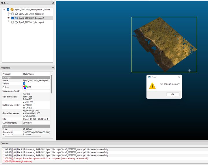

I'm using the Classifier I trained via CANUPO with a point cloud, and after running the CANUPO- Classify plugin, CC sends me this "error: Not enough memory" message.
It's weird because I have plenty of space on my computer's memory. Also, the point cloud doesn't seem that heavy (47, 540 662 points) and I have 48 GB of RAM.
Despite this error message, the final result of the classification (ground vs vegetation) seems right, but I'm still worried about the "not enough memory" message.

- CANUPO-result.png (163.65 KiB) Viewed 80624 times
- CANUPO-not_enough_memory.png (167.06 KiB) Viewed 80624 times

Looks strange indeed! Which version are you using?
Are you able to reproduce the issue on a smaller cloud? (like a small portion of the big cloud)
If yes, would you be able to share it with me (along with the .prm file)? (to admin[at]cloudcompare.org)

I'm using CloudCompare v2.13 alpha [64 bit].
Yes, if I use a smaller part of my point cloud, the same issue happens.
On the other hand, I have another classifier (with less class) that works very fine with the smallest cloud, but shows the same "not enough memory" issue with the larger one.
