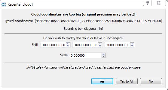

I've got a problem opening a bin file I've been working on for a while - it tells me opening that a cloud co-ordinate is too big, but no matter what options I seem to select it crashes out after the dialogue box as the attached image. Everything was fine before a crash when meshing a cloud, on re-opening the last saved file I got this problem.
No problem (I thought) as I regularly incrementally save the bin file with a new name.... but I've discovered that trying to open any of these crashes out too (no dialogue box, just a straight crash).
The bin file is about 28Mb - has it got too large? Any ideas for recovering my work...?
Thanks (in hope!)
Steve

Very strange indeed! Can you send me the BIN file?

Thanks for looking into this, I can confirm that the new 'Christmas' Release 2.5.2 solves the issue of a corrupt mesh.
The problem mesh has been re-moved and the remaining vertices etc. have been moved into a "Orphans" group - the rest of the file is intact.
