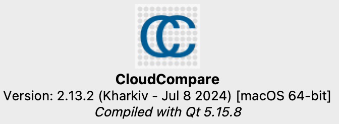

Hello CCers:
I'm running CC on a Mac with M1 silicon.
Attachment 0.jpg (31.51 KiB) Viewed 44178 times
A function related to specifying the center of rotation appears to not be working.
Double clicking does not cause the COR to change.
Any advice on why or how to fix this?
Sincerely,
Ken
