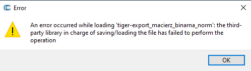

CloudCompare.exe -COMPUTE_NORMALS -O ".xyz file" -SAVE_CLOUDS FILE ".las file"
but created .las file is no openable by CloudCompare. I get error:
"An error occurred while loading 'tiger-export_macierz_binarna_norm': the third-party library in charge of saving/loading the file has failed to perform the operation"

Re: CloudCompare CLI -COMPUTE_NORMALS
So the -O option has to appear first, because you want to load the cloud before doing anything ;)
CloudCompare.exe -O ".xyz file" -COMPUTE_NORMALS -SAVE_CLOUDS FILE ".las file"
And you can also use '-C_EXPORT_FMT LAS' before calling anything so as to have the auto save feature automatically export to LAS (and not needing to call -SAVE_CLOUDS manually). If you don't want to use the auto-save feature, you should disable it.
And sadly, PoissonRecon is not accessible via the command line currently. Note that the original project has its own command line tool: https://github.com/mkazhdan/PoissonRecon
